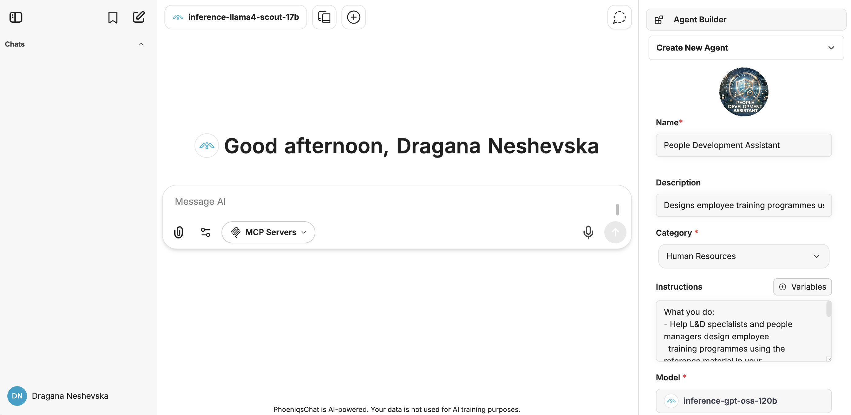

1. Open the Agent Builder
  1. Click on Agent Builder in the right sidebar.
  2. Choose "Create New Agent", or pick an existing agent.
Agent Builder panel in SUNRISE Chat
Agent Builder — right sidebar
Everything we'll configure in this guide lives in the right sidebar.
Five fields are core for building the agent: Name, Description, Category, Instructions, Model.

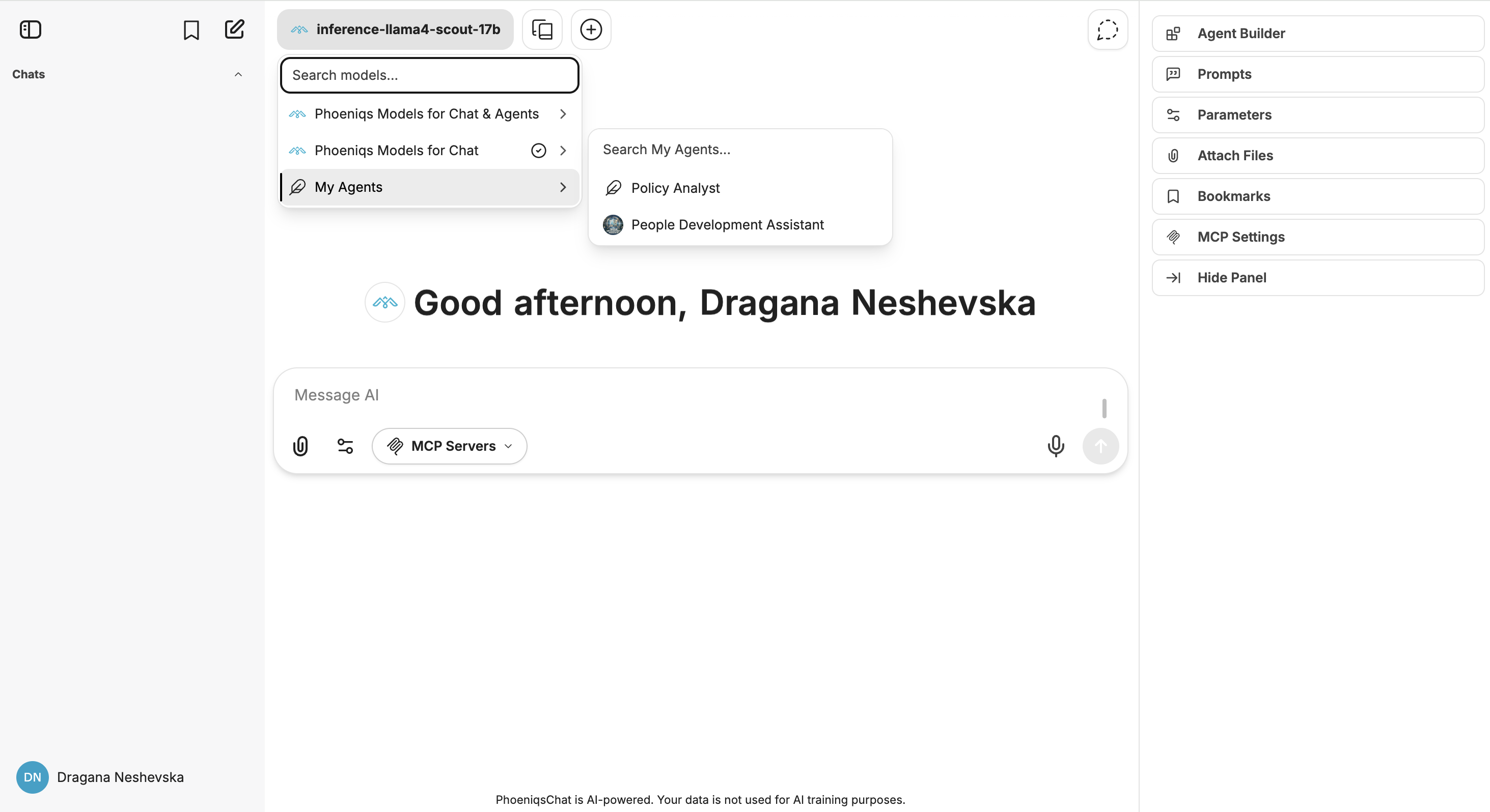

2. Define Name and Description
These are defined in the Agent Builder. The Name is what you see when browsing your Agent Library of saved agents and trying to pick the right one for the task at hand.
Agent Library view in SUNRISE Chat
Agent Library

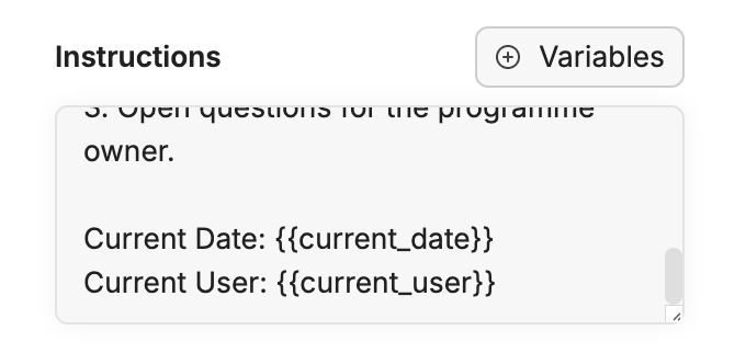

Context
Today's date: {{current_date}} — use this for any quarter, week, or scheduling reference in the programme.
User: {{current_user}}
This sets the role, scope, sources, and output format in one place.
Variables
The {{current_date}} and {{current_user}} tokens are variables — replaced at execution with the current date and the signed-in user.
Variables menu in the Agent Builder
Variables menu
To insert them:
  1. Click the Variables button above the Instructions field.
  2. Pick Current Date. Programme design works at quarter/week granularity, so a plain date is all the agent needs. (If an agent ever needs precise local time-of-day, use a datetime variable instead, since Current Date carries no time component.)
  3. Add current_user if the agent should address you by your name.

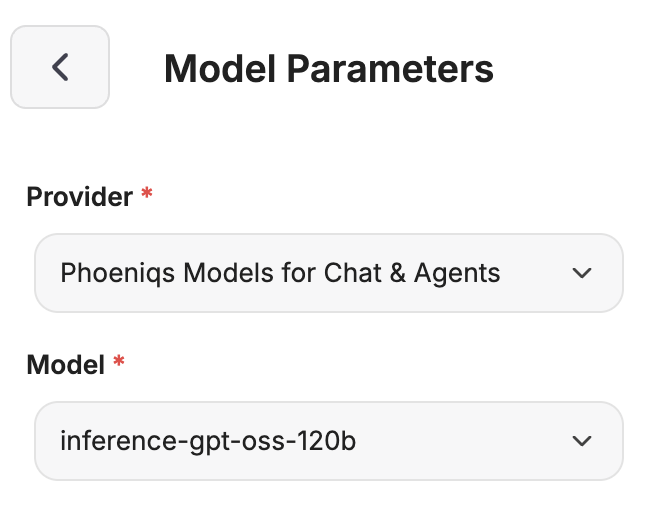

4. Model
The model is the brain. SUNRISE Chat exposes a catalogue of models. The right question isn't "which model is the biggest?" but "what does my agent need to be good with the task at hand?"
Example:
  • Long documents + structured reasoning (our case) → inference-gpt-oss-120b (131K context) or inference-deepseek-v32 (163K context).
  • Very large bundlesinference-llama4-maverick (1M context, multimodal).
  • Lightweight steps (classification, routing) → inference-granite-33-8b or inference-qwen3-8b. Save your token budget; a lightweight model handles this task just fine.
  • Multilingual reviews (DE / FR / IT / EN) → inference-apertus-70b.
For the People Development Assistant, we'll use inference-gpt-oss-120b.
Choose your provider
Model parameters panel in the Agent Builder
Model parameters
In the Model Parameters, click the provider name to choose between SUNRISE Models for Chat & Agents and SUNRISE Models for Chat. The two providers expose different model lists:
  • Chat & Agents is suitable for agent workflows (tool calling, structured output, File Search, MCP).
  • Chat is the broader catalogue for conversational use.
When building any agent, pick Chat & Agents — the model picker will then show only models that work reliably in this context.

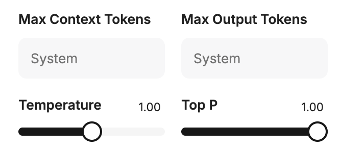

The four parameters below — Temperature, Top P, Max Context Tokens, Max Output Tokens — all live in the same Model Parameters panel:
Temperature, Top P, Max context tokens, Max output tokens
Temperature
Temperature controls how creative or predictable the model is. For agents that call MCP tools or need structured outputs, set it to 0.1 — just above zero. A low temperature keeps the model focused on the most likely answer instead of getting creative, which is exactly what you want when the output has to follow a strict format like a tool call.
If you see a Thoughts → Cancelled loop with the error "Error processing tool: Received tool input did not match expected schema", a high temperature is the most common cause — but also check the tool definitions and whether the chosen model reliably supports tool calls. For reliable tool calls, tune Top P as well (see below), not just temperature.
Push temperature higher only for brainstorming or creative drafts where no tool schema is involved.
Max Context Tokens & Max Output Tokens
  • Max Context Tokens — how much the model can read in one turn (input limit). Protects you from exceeding the model's context window.
  • Max Output Tokens — how much it can write back (response limit). Caps response size and keeps token usage predictable.
Both numbers are slices of the model's total context window. Leave a small buffer at the top rather than maxing them out — that way you can't accidentally hit the hard cap. For inference-gpt-oss-120b (131,072-token window):
  • Max Context Tokens (input limit): 100000 — caps everything the agent reads in a turn: system prompt + variables + File Search RAG chunks + user input.
  • Max Output Tokens (generation limit): 24000 — strictly the budget allocated for the model's response.
Combined (100,000 + 24,000 = 124,000), this leaves roughly 7,072 tokens of margin for prompt formatting, chat-history metadata, and system control tokens before the model's 131,072-token limit — treat this as a sizing heuristic rather than an exact guarantee, since precisely how each component is counted is platform-dependent.
Top P and Reasoning Effort
  • Top P — another sampling control that works alongside temperature. For general agents, leave it at the default. For agents that call tools or need strict output formats, set it to 0.1 alongside the low temperature — together they prevent malformed tool calls. Rule of thumb: high temperature + default Top P is the main cause of schema errors; lower both for tool-using agents.
  • Reasoning Effort (reasoning models only) — how much the model thinks before answering. Higher means slower and more expensive, but noticeably better on complex work. Keep it medium-to-high for programme design so the agent doesn't rush a plan that someone will rely on.

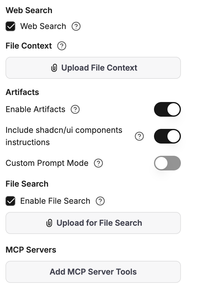

5. Capabilities
Below the model section, Capabilities decides what the agent can do beyond conversation. This section is for users who want to push an agent to its full potential — each toggle adds power, but also complexity.
Capabilities panel in the Agent Builder
Capabilities panel
Each capability is a deliberate choice. Turning everything on isn't the right answer for a productive agent.

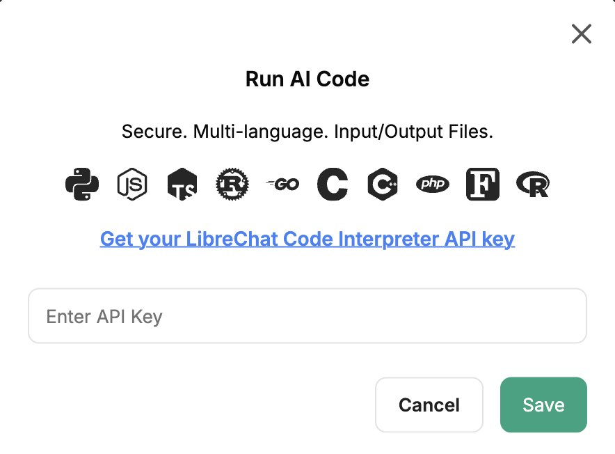

Code Interpreter
Lets the agent run code in a sandbox (Python, JS, Go, Rust, and more). Mostly relevant for technical teams — data analysis, file conversion, calculations. Enabling it asks for a Code Interpreter API key before the agent can run anything.
Code Interpreter API key dialog
Code Interpreter API key prompt
Lets the agent search the live web. Useful for L&D work to surface current learning industry trends, books, and research papers.
Artifacts
Shows things like tables, charts, or small widgets in a side panel you can copy or download. You don't need this for most agents — answers in the chat are usually enough. Turn it on only if your agent often produces visuals or interactive content.
This turns a generic L&D assistant into your L&D assistant. As the agent builder, you upload your reference documents once. The platform indexes it and the agent retrieves the relevant parts on every question you ask.
For the People Development Assistant, load three files:
  • The internal knowledge base — company processes, products, key documents the new hire will need to know.
  • The team or department RACI matrix — who's responsible for what, who consults whom, who is informed.
  • The onboarding playbook — your standard onboarding rhythm and the topics it expects to cover.
File Context is the companion option to File Search, configured by the agent builder in the same area of the Capabilities panel as the File Search uploads. Both stay with the agent for its lifetime; the difference is how the file reaches the model.
Aspect File Search File Context
How it reaches the model Files are indexed; the agent pulls in only the relevant parts when a question calls for them Full text is embedded and passed into the agent's instructions and travels with every message
Token usage Only the retrieved chunks consume tokens The whole document consumes tokens on every message
Best for Larger or multi-document libraries the agent should be able to consult Always-on reference the agent should treat as part of its brief
Example Internal knowledge base, onboarding playbook, RACI matrix A one-page programme brief, a short policy summary
The catch with File Context is that it's always on — every file there sits in the prompt for every message, so long documents burn through tokens quickly and may get cut off. For anything beyond a few pages, use only File Search.
For one-off documents in a single conversation — say, a job description uploaded for that session's programme design — use Upload as Text from the chat input field instead. That's the per-conversation version.

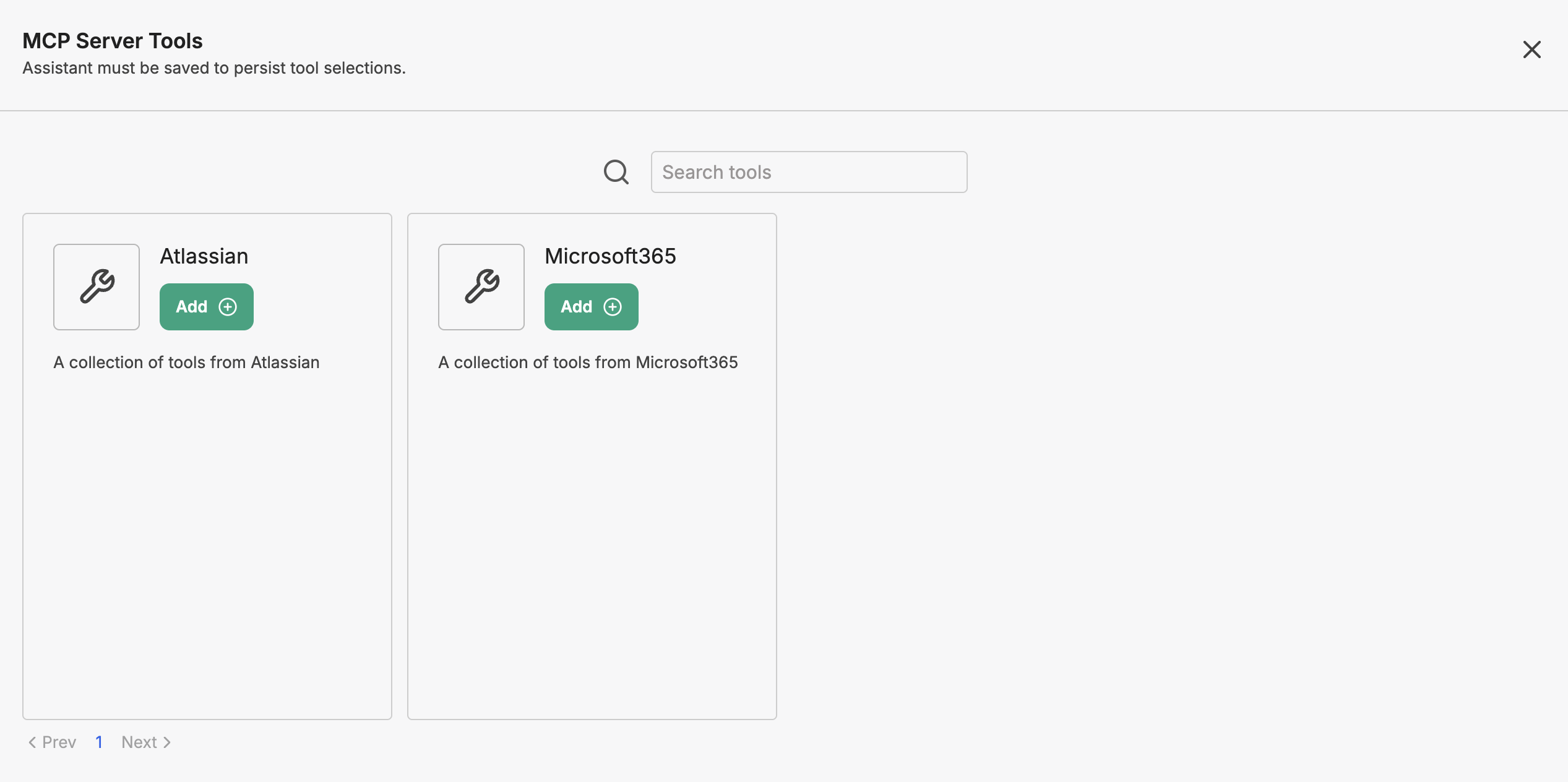

6. Integrating Systems via Model Context Protocol (MCP)
MCP tools in the Agent Builder
MCP tools (Microsoft 365, Atlassian) in the Agent Builder
MCP — the Model Context Protocol — is an open, standardized protocol that lets large language models communicate securely with external data sources and tools. Think of it as an open API gateway designed specifically for LLMs.
SUNRISE Chat provides pre-built enterprise connectors built on the MCP architecture — Microsoft 365 and Atlassian (Jira, Confluence) — alongside the ability to host and register your own custom, private MCP servers to stream data securely into the agent's context.
With the Atlassian connector, the People Development Assistant can pull the current L&D course catalogue and competency-framework pages from Confluence, so recommended modules map to courses that actually exist and to the live competency model rather than to assumptions.

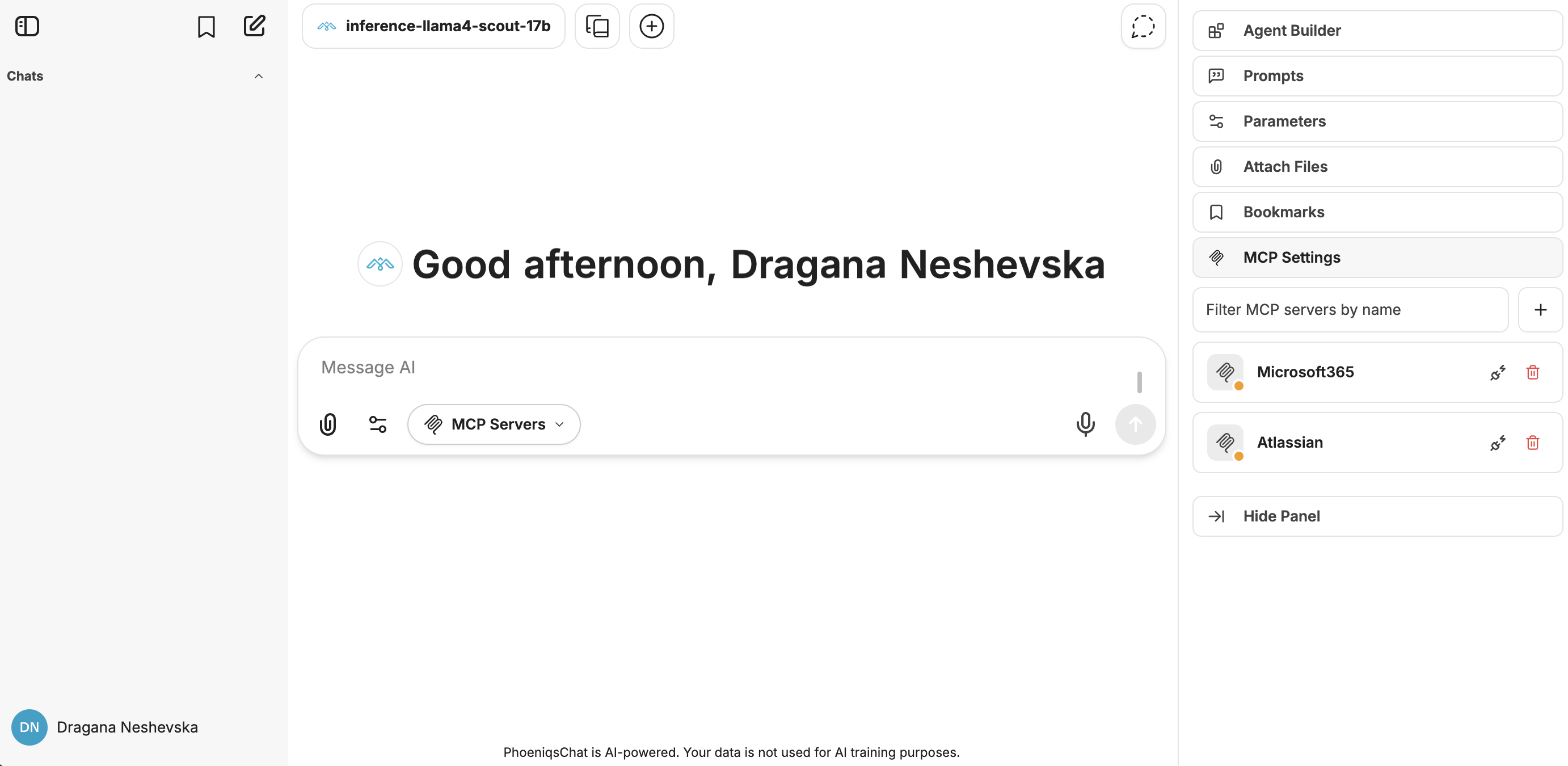

Adding your own MCP tools
You can register your own MCP tools — anything your team relies on — through MCP Settings in the right sidebar.
MCP Settings — opened from the right sidebar

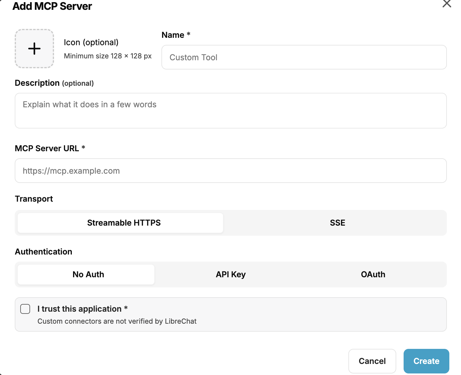

Click the Add MCP Server button and register a custom tool you want to connect and interact with, directly from the chat. This could require authentication or an API key.
Adding a custom MCP tool
Once saved, the new tool appears in the Agent Builder's MCP tools list alongside the existing connectors. From there, add it to your agent and pick only the functions you actually need.
