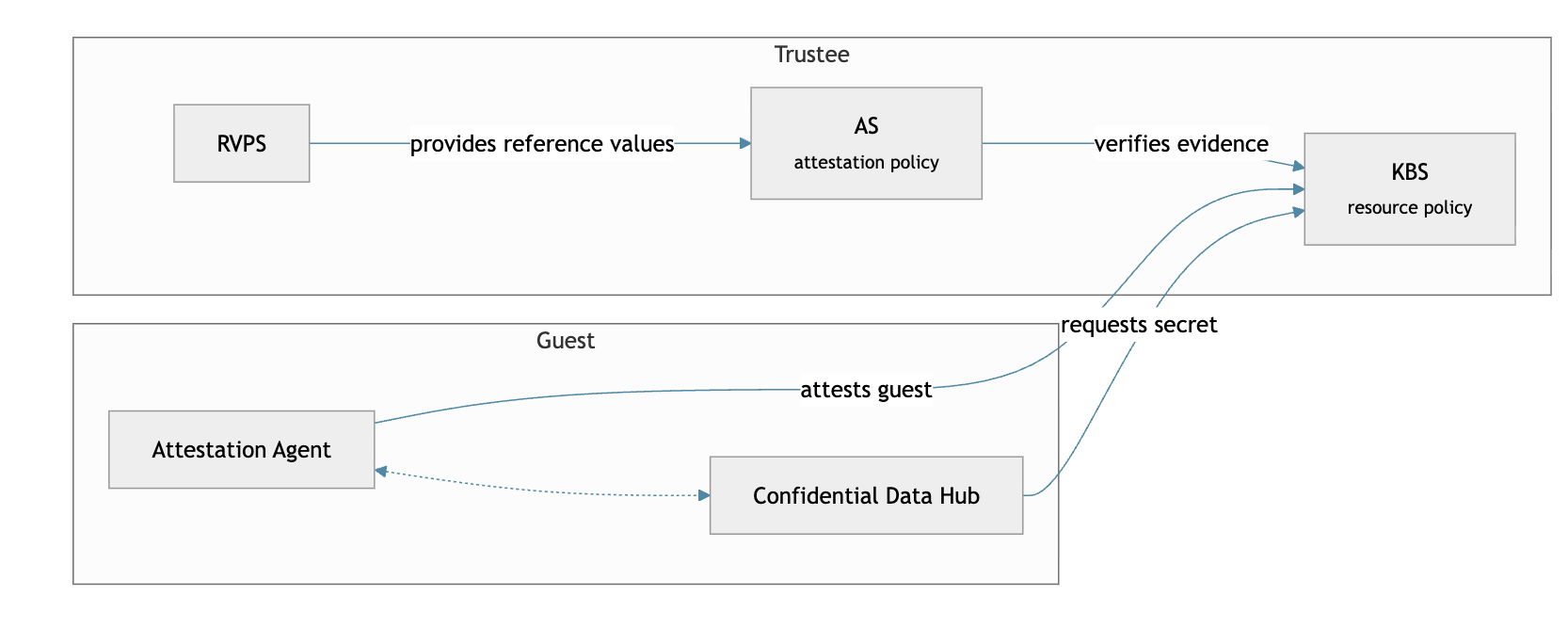

The Confidential Containers (CoCo) ecosystem we build on includes Trustee, an open-source project that bundles a set of services for attestation and secret release. That's exactly where the heart of the flow lives. The signed attestation report and its certificate chain prove that the measurements came from a genuine TEE platform, however, they are not enough to establish trust in the workload. The in-guest Attestation Agent submits its evidence to the Key Broker Service (KBS), the entry point, which hands it to the Attestation Service (AS) for verification. The AS checks the evidence authenticity, compares the measurements against trusted reference values from the Reference Value Provider Service (RVPS), and evaluates them through attestation policy. The result returns to the KBS, which then applies its own resource policy to decide which secrets, if any, this workload may receive. The requested secret is released only if both attestation and resource policy evaluation succeed.
The components:
  • Attestation Service (AS), validates the evidence authenticity and attest it using the attestation policy
  • Reference Value Provider Service (RVPS), holds the trusted reference values that the workload's evidence is compared against, typically the known-good measurements of the TEE platform and boot.
  • Key Broker Service (KBS), the gatekeeper and entry point. Receives the evidence from the guest, drives verification, and decides which secrets this workload may access, based on its own resource policy.
  • Attestation Agent (inside the VM), gathers the evidence and submits it to the KBS.
  • Confidential Data Hub (inside the VM), fetches and unwraps the secrets once the KBS releases them.

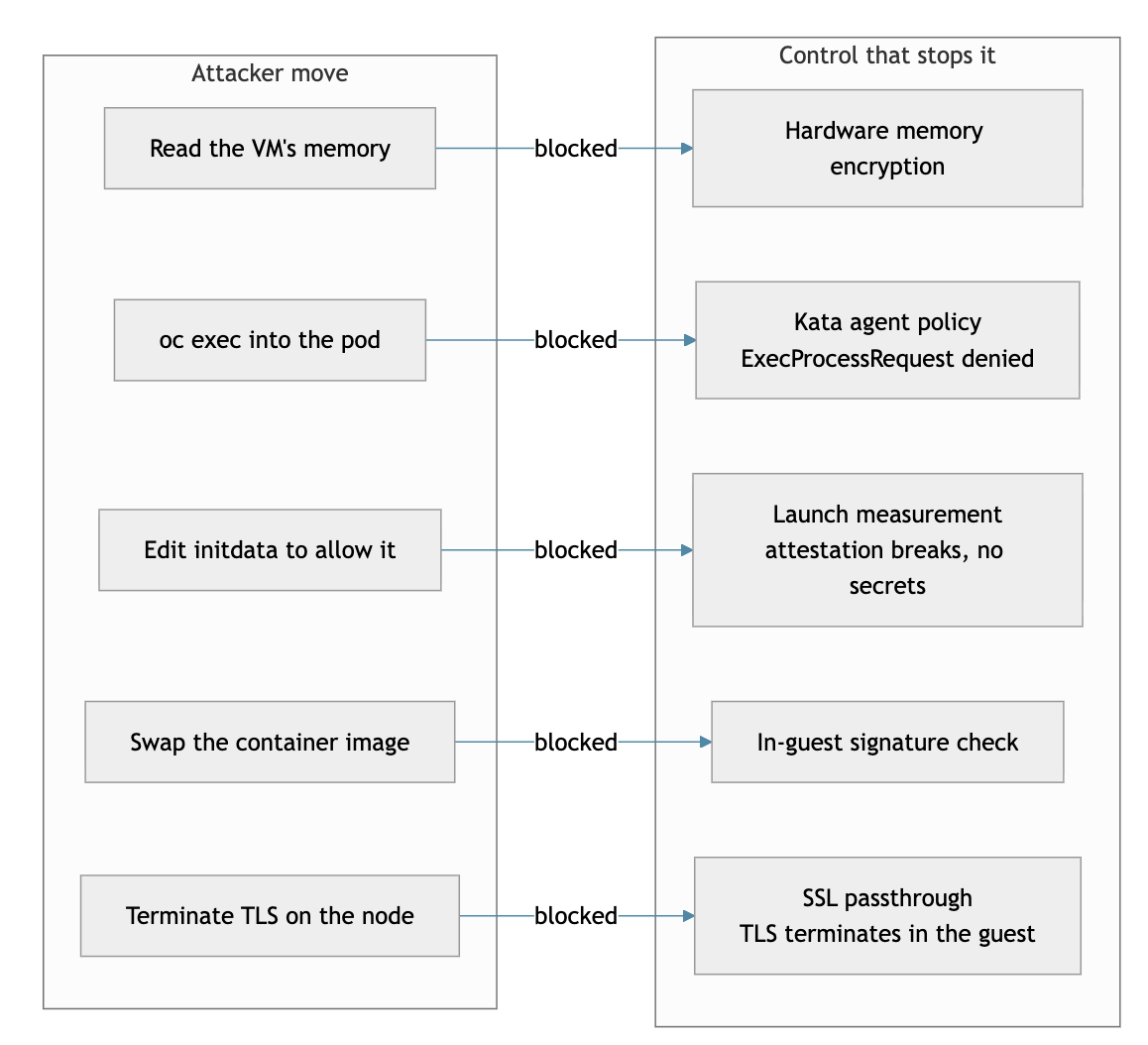

The security intent lives in initdata: an initdata.toml, gzip-compressed and base64-encoded, attached as a pod annotation. It can carry a custom Kata agent policy that overrides the guest's built-in default (governing what the guest allows the host to do), the Trustee address and its TLS certificate, and the image verification policy. The hash of initdata is bound to the attestation report and becomes part of the attested state. A cluster admin can't quietly change the policies or repoint Trustee elsewhere without breaking attestation. The policies governing guest behavior become part of the attested state, not just runtime configuration. The three things it carries, the agent policy, the image policy, and the trust anchor for Trustee, are also where the boundary stops being a diagram and starts being enforced, so it's worth looking at each in turn.
Take the kata-agent policy first. The kata-agent acts as a bridge between the host and the workload, managing container lifecycle, enforcing security policies, and monitoring processes just as a traditional container runtime would, but isolated inside a micro-VM. That API is precisely what a malicious host would reach for, so the agent policy acts as an allowlist over it: it declares which agent requests the guest will honor and refuses everything else. The call that matters most is ExecProcessRequest, the one behind kubectl exec / oc exec. Left unrestricted, it would let anyone with host access run arbitrary commands inside the confidential workload and read whatever the TEE was meant to protect, so a confidential deployment denies it, and likewise locks down the stream-reading and volume-mount calls that would otherwise hand the host a way in. Restricting this host-to-guest interface isn't optional hardening; it's what keeps the host on the outside of the boundary.
The image verification policy is the second piece, and it's where supply-chain trust enters the picture. A signed image is a cryptographic guarantee that the image hasn't been altered since it was built and signed by a trusted party, the signature is what ties the running code back to its origin. The policy itself, which signatures and signing keys count as valid, is what initdata carries; the check it describes runs inside the guest, at image-pull time. Before a workload starts inside the TEE, the in-guest runtime pulls the image and verifies its signature against that policy, and if the signature is missing or invalid the launch is aborted rather than run. Because the policy travels in initdata, its hash is already part of the attested state, so an operator can't quietly loosen the rules to admit an unsigned image without breaking attestation. And the enforcement point being inside the guest is what makes it robust: even a compromised registry doesn't help an attacker, since a substituted image won't carry the signature the policy demands and is rejected before execution. The TEE isolates the workload; the signature check is the software mechanism that guarantees it's the right workload in the first place.
The same boundary has to hold at the networking layer, and here it's easy to slip. Traffic to anything running as a confidential workload must be decrypted inside the TEE, not in front of it. On OpenShift that means the route or ingress sitting in front of the pod has to pass the encrypted connection straight through, SSL passthrough, so that TLS terminates inside the guest. If the route/ingress instead terminates TLS at the edge (or re-encrypts at that layer), the traffic is decrypted to plaintext on the untrusted worker node, outside the attested boundary, which hands anyone with access to that node a window onto exactly the data the TEE was meant to protect. With passthrough, the plaintext never exists outside the confidential VM. The rule isn't specific to any one workload: it holds for every confidential endpoint, Trustee included.

Attestation policy lives in the Attestation Service and defines how attestation claims are evaluated and what conditions must hold for a workload to be considered trustworthy. Measurements and reference values are usually the most important inputs, but they are not the only claims a policy may evaluate. Most deployments spend more effort managing reference values than writing policy code. Policy expresses the logic; reference values define the state that logic evaluates.
Resource policy lives in the Key Broker Service and answers a different question: a workload that has been judged trustworthy, which secrets is it entitled to? The KBS acts as the policy enforcement point, once attestation succeeds, its resource policy decides which gated resources are released to that workload. In practice it's also where a deployment picks its posture, from a permissive policy that releases freely in development, to a strict, fine-grained one that gates every resource in production.
The third layer we've already seen up close: the guest policy enforced by the Kata agent inside the confidential VM, the policy controlling the host-to-guest RPC surface exposed by the agent. ExecProcessRequest (behind oc exec) is the obvious one to deny, but it isn't the only call that matters: ReadStreamRequest would let the host read a container's stdout/stderr, volume-mount calls could graft host-controlled storage into the guest, and SetPolicyRequest is the subtle one, if policy updates are permitted, a host may be able to weaken the policy before invoking otherwise restricted operations. The policy has to account for all of them. Naming it here places it alongside the other two: attestation policy decides whether the workload is trustworthy, resource policy decides what a trustworthy workload may unlock, and guest policy governs what the host may ask of the workload while it runs. Restricting that host-to-guest interface isn't optional hardening; it's part of the overall security model.

The operator who tries everything
It helps to make this concrete. Picture a cluster administrator who decides to read what's inside a confidential workload, not an outside attacker, but someone with full control of the platform. Memory encryption stops them from reading the VM's RAM, so they try the host instead: oc exec into the pod. The Kata agent policy doesn't list ExecProcessRequest, so the request is refused at the guest boundary. Fine, they edit initdata to allow it. But initdata's hash is folded into the launch measurement, so the VM now attests to a different state, the reference values no longer match, and Trustee releases no secrets: the workload starts, but stays locked. They try swapping the container image for a patched one that phones memory home; the in-guest signature check rejects it before it runs. They point the route's TLS termination at the worker node to sniff plaintext; the traffic was passthrough, so there's nothing to read outside the TEE. Each move is defeated not by a different control bolted on after the fact, but by the same principle: the boundary is enforced by attestation and measured state, not by who holds admin. The one component that could undo all of this, Trustee, is the one we put out of their reach entirely.
