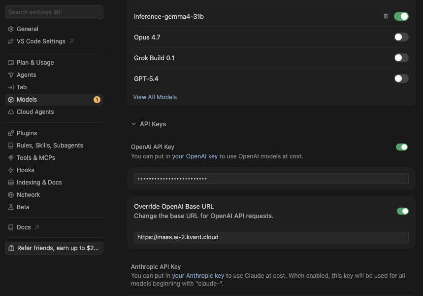

Step 2. Add Your Sunrise API Key
Paste your Sunrise API Key into the OpenAI API Key field, then set Override OpenAI Base URL to:
https://maas.ai.sunrise.ch/v1
Make sure both toggles are enabled (green).

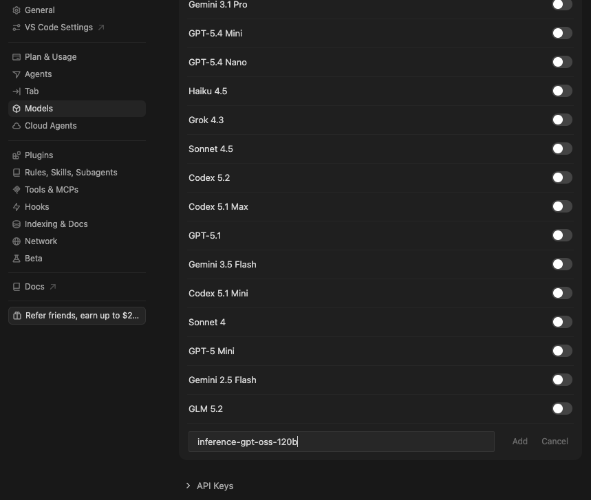

Step 3. Add Your Model
At the bottom of the model list click on "Add a model". Get the exact model name from the Sunrise Active Models list. For example:
inference-apertus-70b
inference-gpt-oss-120b
inference-glm5
Recommended: Use inference-glm5 for the best Cursor experience. GLM 5 is optimized for agentic engineering and long-horizon coding, and is the only model that fully supports Agent, Chat, and Plan modes in Cursor.
Paste the name into Cursor and enable the toggle for the newly added model.
